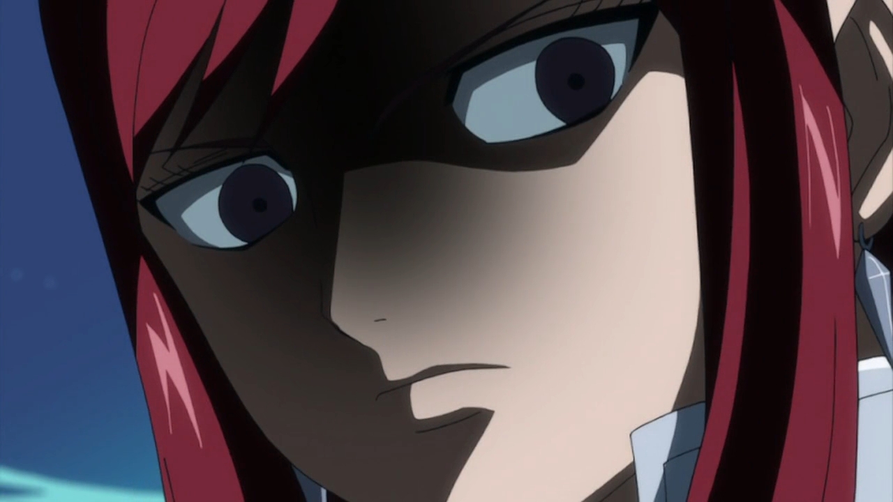

    now let's get back to the core which is the lossless rendering with VDM and Lagarith, the source is YUV color space and i heard that if the process like this YV12>>RGB>>YV12 again, this gonna be lossy. and yeah i forget to mention that i still have to add the lossless output to After Effects to add such stuffs some kind of lossless avi watermark and karaoke or whatever that means 2 lossless rendering one with VDM and second with AE (Dam it the 2 outputs exceeds 100GB xD well who cares)
    Please note that if i render with VDM and Lagarith in YV12 mode it gets Color Banding (output size kinda 14GB) i don't know how that can happen after using a debanding filter and a lossless rendering while i don't have it in RGB mode like this pic
    so i need your suggestions guys all i want is to retain the final lossless output with the maximum quality as possible as i can

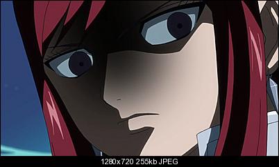

    didn't get you buddy if "CODEC A" represent the source video well check this pic from the same frame like the pic above but without filtering
Name:	New File013578.jpg
    so if i applied my editing in AE directly without cleaning up the source first the final outputs (720p or 480p) will be kinda miserable

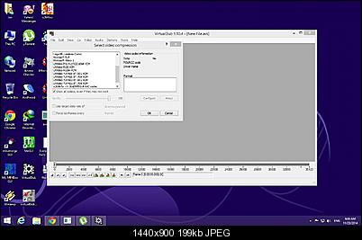

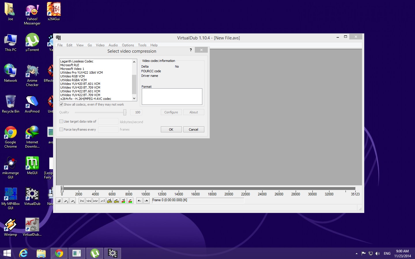

    if i'm about to manage the conversion from YUV>RGB with VirtualDub which of the below codecs should i use
    and in the avs script what ConvertToRGB() should look like ?
  25. Why are you using vdub? What operations are you doing ? If you convert to RGB in the script beforehand, use lagarith RGB or ut video RGB
    Use Rec709 (standard for HD) for everything (converting to RGB, and back to YV12) , and you will be ok
    The SD version requires an extra colormatrix conversion (709=>601), buty ou can do that in the script with ConvertToYV12(matrix="Rec601"), if you're coming from the AE RGB export

    my bad i didn't clarify it well i mean that and the avs script which will contain the filtering and the YUV>RGB conversion, it needs rendering right ? whatever the program i use VD or VDM or AviUtl or whatever it needs a codec to be render with so which of these lossless codecs should i use
    and uhm so i use in the script ConvertToRGB(matrix="Rec709") ? okay sounds good
    Edit: okay thanks i'm really grateful buddy
  27. I see, you're using vdub to encode only.
    Yes, ConvertToRGB(matrix="Rec709") is good for HD source material.
    The YUV method is higher quality (less quality loss because you're up and down sampling the chroma), but if you *need* AE, then the RGB trip is unavoidable . The quality loss is visible only with clean colored lines , like clean animation, clean titles, and only to some people (averge joe won't be able to tell). Your audience is anime fans, so they might be able to tell; they tend to be very picky about lines. With live action content is usually difficult to see the degradation unless you zoom in .
